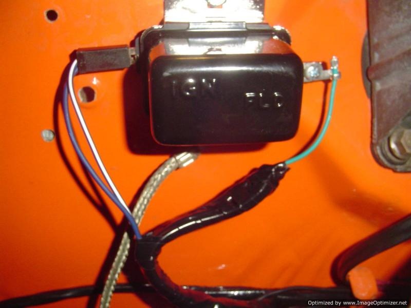

Been away from this for a few days but I think you guys are on to my problem. The VR is a solid state version of the 1969 model so it's new but looks original. The alternator was in the car when I got it but after some research it seems to be an after 69 model as it has two FLD terminals and also a small connection post on it as well. I jumpered the terminals on the VR and still no charge so it has to be the alternator. I was thinking about buying a new one with the correct setup of only 1 FLD terminal but if I just have to jumper the unused FLD to ground that would be cheaper. Does it matter where I ground the unused FLD to? Also in the pics it shows a ground strap from the base of the VR to the engine block so I should be ok there. Thanks for all the help........ One more thing, it is the same distributor that is talked about in the HEI thread.

Yes you need to ground the unused terminal. You can run the ground wire to any good ground. An easy way is to do it, is take out the screw on the terminal, remove the insulating washer, put a metal washer on it and put the screw back in. This will ground it.
