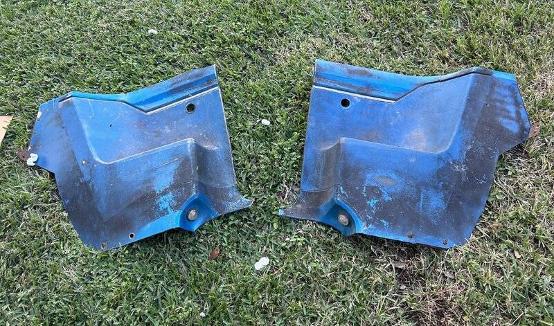

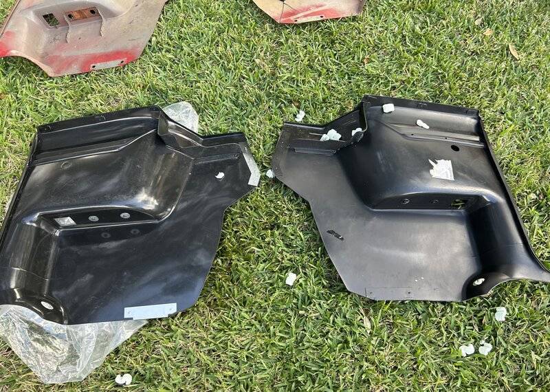

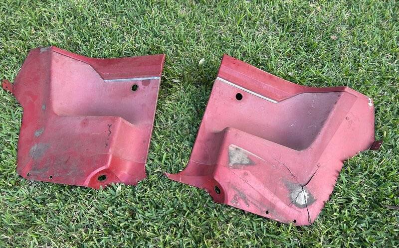

Hi All ... My build project is moving along while my bank account shrinks. Paint is done and needing help sourcing rear qtr panels. One of our members was gracious enough to pull ones he had in storage out (see pictures). The aftermarket ones are designed for convertible Darts and "can work" but are not apparently a proper fit, per Laysons and ClassicIndustries fitment notes.
So, the other member and I are not clear what the real difference is or if that matters. Hoping one of his 3 pair is for a Bcuda and that someone out there can look and verify?

It is the top of the panel that hugs the quarter panel that is different, you don't show that area well with the pictures you posted. The Dart is more straight while the Barracuda has a bulge and is more round, hard to explain...

In this pic you can see the passengers side rear panel. Notice how it is flared up just a bit at the rear where it meets the top. The Dart panels are straight there. It is hard to tell in your pics but it looks like those may be for a Dart

I think I see what you are speaking about ... So in you opinion, will Dart panels work or will it be a significant visual "thing" I'd be obsessing over for years? Also, looks like you did a great classy detail on yours. Could you send me a close-up of that and let me know if it's simply painted, or covered, or what you did there?
