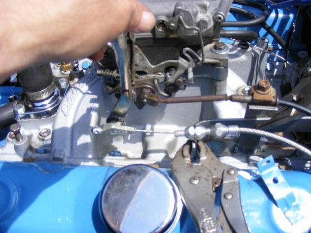

I used a Lokar kickdown cable with my 360/904 in my 66 Dart.I had to modify my throttle bracket,but was alot easier then finding linkages!
