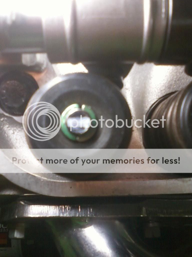

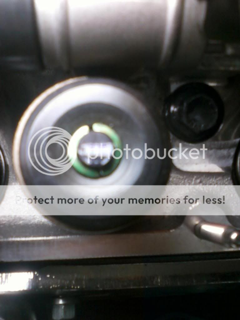

i am in the final assembly stages of my engine. it is a 383 with eddy heads. comp cams magnum roller rockers. cam is comp cams. 525 lift. i have already verified top dead center on the #1 cylinder and check for valve to piston clearance (.085). i am checking my rocker arm geometry and this is where my problem is. i cant get my head around it. I assembled one intake and one exhaust rocker and marked the tip of the valve stem with a marker. then i rotated the engine a few times by hand. the marks are dead center of the valve tip. the adjusters on the rocker arms show 3 threads showing. does this look right? or do i need longer push rods? if i do a longer push rod will if change my geometry? here are some pictures.

my current push rods are 8.555 long. they sell them in 8.600. that i think would bring them in a full thread. i was planning to spin this engine to 6000-6500.
Check the rocker arm manufacturers specs, Crane used to say 3/4 of a turn below the rocker was optimum. Longer pushrods won't change the pattern on the valve stem since these engines are a rocker shaft type setup, but the patttern on your valve stem tip looks fine, so you have no worries there.
got my new push rods. they now have 1 1/2 thread showing out the bottom of the rocker. that is at zero lash also. should be just about 1 thread once i dial in the valve lash. much happier with the new set up.
