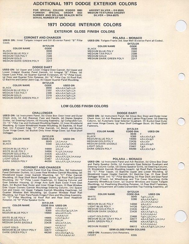

GaryS Well-Known Member Joined Nov 5, 2009 Messages 670 Reaction score 84 Location Ponder, TX Apr 19, 2015 #2 The Ditzler code is shown here: http://images.tcpglobal.com/chips/1971-Dodge-pg02.jpg
Bunker45 Well-Known Member Joined Apr 2, 2013 Messages 214 Reaction score 7 Location Ohio Apr 19, 2015 #3 Thanks!, got it!
