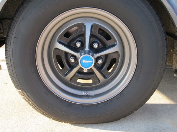

Heres a pic of my magnum 500, not argent, I wanted something a little darker to go with my charcoal car color.
Just a tip on how I did mine. I didn't have the template, I painted the black first, covered each black opening completely with masking tape, I didn't try to run the edge of the tape around the opening, I simply bridged the entire area right over the spokes, then I trimmed around each opening with razor. Then I sprayed the silver.
Good luck with yours, post some pics when your done.
