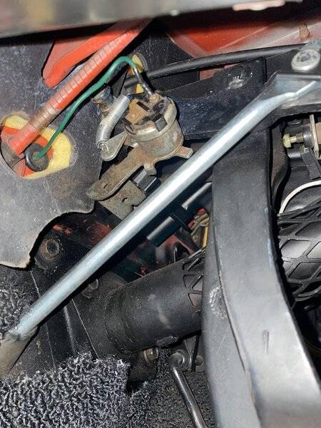

J.B. Well-Known Member Joined Dec 5, 2020 Messages 241 Reaction score 121 Location Florida Dec 17, 2023 #1 I need a photo/photos of where on the clutch petal platform i am supposed to bolt up the clutch safety switch.

BrianT Here we go again... FABO Gold Member Joined Mar 13, 2007 Messages 6,073 Reaction score 3,018 Location Kansas City, Mo Dec 18, 2023 #4 This is my 1970 Duster, it should be the same as your 71.
7 71Adust Member Joined Apr 11, 2021 Messages 17 Reaction score 7 Location 44857 Dec 18, 2023 #5 Hope this helps
J.B. Well-Known Member Joined Dec 5, 2020 Messages 241 Reaction score 121 Location Florida Dec 18, 2023 #6 Im trying To see how it bolts on i still cant tell where it bolts up i see the orientation of it so will have to play with it
7 71Adust Member Joined Apr 11, 2021 Messages 17 Reaction score 7 Location 44857 Dec 18, 2023 #7 This is back side
J.B. Well-Known Member Joined Dec 5, 2020 Messages 241 Reaction score 121 Location Florida Dec 18, 2023 #8 Yup thats it that works thank you
