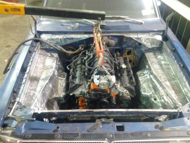

It takes very little to turn out a lot of power. I think just a cam and a stroker kit, which takes the bad pistons and rods out of the equation, puts it at around 650 hp. Lots of available power in these motors. Here is the motor test fit in his Warlock.
Here it is test fitted in a 1970 Dart with the HDK front suspension and K-Frame set up.
