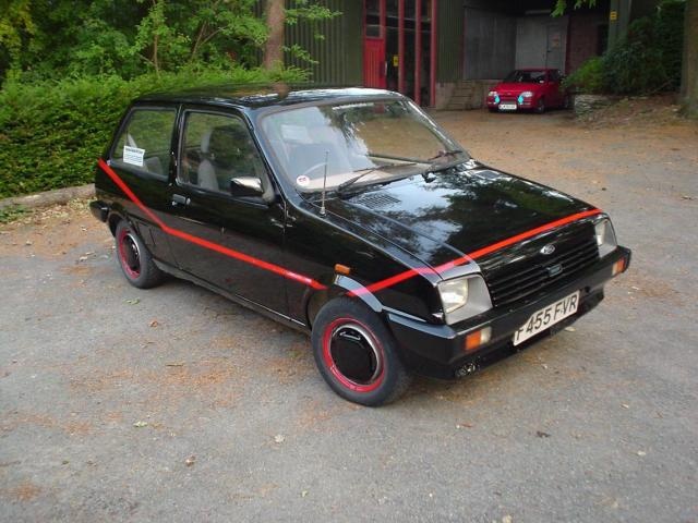

I sprayed mine with interlux brightside boat paint and it looks pretty damn good. It's single stage urethane.
