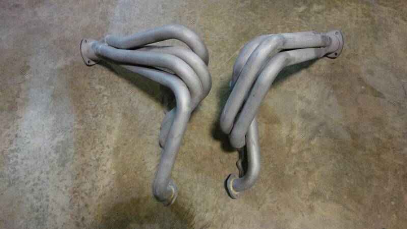

looking for pictures of your custom headers in an early A-body with LA engine. does anybody have two tubes under the car and two out the fenderwell like ProParts big block later A-body headers? Thanks!
Built these 1-3/4" full fenderwell headers for my 64 Barracuda with W2 heads. Seems like the same process could be modified to put two tubes below and two out the fenderwell. These do not rub on 205-60R15s lock to lock even over bumps.

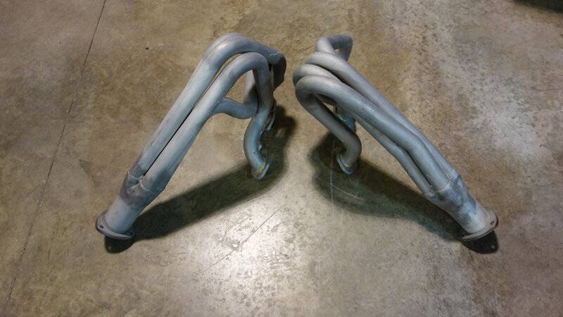

I have a custom built pair for a big block a-body, but they were in a 70 Duster so that may not help. They are also HUGE tube, with the front cylinder on each side thru the k member. One side has the other three thru the wheel well, other side has one under chassis, and two thru the wheelwell. I can get pics tomorrow if it will help.
(2 1/4 tube, stout 540"up engine)
