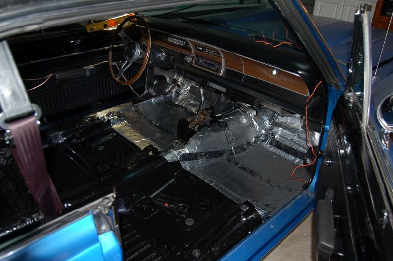

Gutted my interior, ground down the one rusty area to bare metal and then coated the entire interior with POR15. Worked like a charm, and the sound deadening material I put down (B-Quiet) stuck to it w/o any issues.

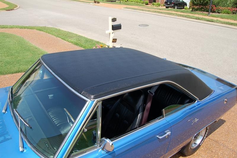

Also applied it to the roof after the vinyl top was removed and applied primer over it before the new vinyl top was put on. Part of that project was to replace the headliner, and once it was removed we POR15'ed the underside of the roof so the metal is now sandwiched between two layers of POR15.

Where did you get that BQUIET. Id like to check on that . I priced FATMAT and had sticker shock.Your car is looking really good!!
