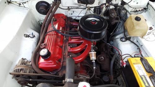

5 years on this slant I modified to drive as a daily driver here in Arkansas, hot days was no problem for this set up, fresh air breather box out of a Jeep, 390 smooth running four barrel holley with a split manifold dual exhaust, this little 170/6 kept me on the road as a daily driver for 5 strong years and 20.000 miles of in town and a few long trips :color:
Love this engine, going to miss it :glasses7:

That's another good looking Slant 6! I like that Jeep breather box that looks pretty cool.

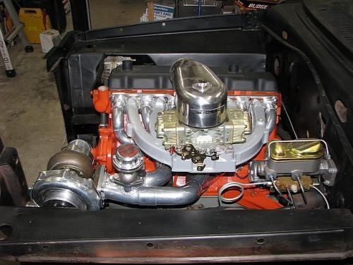

And here's the new one I'm building out of a 75 Duster. Will also be turbo.
No pics yet as I am in the process of assembling the motor. It is a 65 block bored 30 over, the block decked 90 thou, head cut 10 thou, mild port and polish with engnbldr 1.70/1.40 stainless steel valves coupled with 340 valve springs. Cam is the original that was re-ground by Oregon to their 346 grind (234/228 @ .050 or old style numbers .476/.479). Compression will be around 9.4 to 9.6 to 1 depending on which head gasket I use - FelPro or stock steel. I haven't decided which intake to use yet - a Dutra Hyperpac or Offy 4 barrel coupled with the FiTech fuel injection or my triple DCOE45 Weber combination. Exhaust will be a set of early Clifford long tubes for an early A with power steering. With a 4 speed I expect it ought to run OK.
WOW! That thing is sweet! I bet that car is a blast to drive lol. Nice engine! :D
Thanks for the nice comments! It makes about 360 horsepower (with a stock-sounding idle) on 15 pounds pf boost. It should run good on the street, but will never see the street, as it's just a motor to have fun with on the drag strip...
Stock slant six A bodies usually can manage to run some mid-eighteen-second elapsed times in the quarter mile at about 74 mph. Only ten pounds of boost will improve that to mid-fourteen second elapsed times at about 85+mph.... an astounding jump in seat-of-the-pants "feel."
It gives the slant a whole new lease on life. Not easy nor cheap, but well worth it if you have the time, patience, and money to make it happen!
Guaranteed to put a HUGE smile on your face.... :glasses7:
