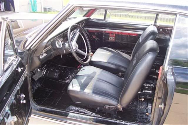

When I did my floorboards with HushMat, I covered the inner door panels also. Not the greatest pic, but you get the idea. I just covered everything that the door panel covers.
