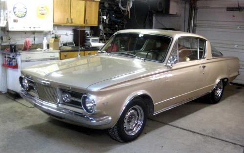

On my '65 I put on 14x7 Chrome rally style wheels with 4.25 back space. Tires are 195-70 in front and 215-70 in the back. Passenger front wheel barely rubbed on the upper A arm in a couple of spots a couple of whacks with a hammer and a touch with the grinder and all was good.
