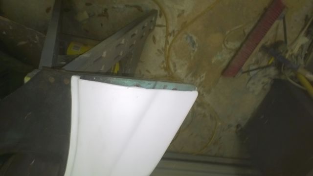

finished mold and pulled part for convertible trim panel

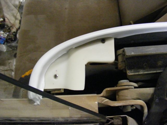

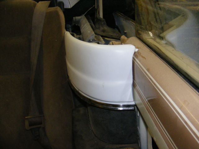

pulled the part to test fit

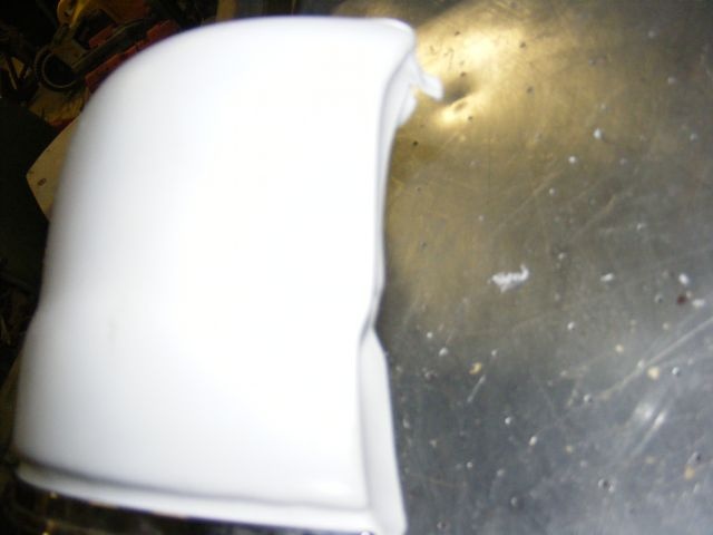

hmm came up short(forgot to take account of the shrinkage..oops) gotta fix that

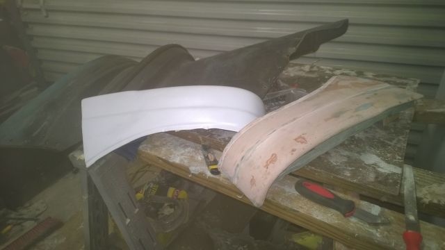

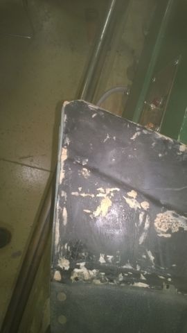

even the original came up short??????
shrinkage is going to haunt me!!!! trim doesn't fit right. I'll have to adjust the mold for that.
not too bad on the top fitment. the huge undercut need to be solved by extra help in the bending and forming stage to curl it in like the original.
you can see how much I have to adjust and rework the mold BUT it's getting there!:rambo:
even with the fit being off so bad for me it's still a better part than
I had. now for the fixes.
the easy part of the fix for sizing is now on!
as you can see it still needs work but I AM getting there.

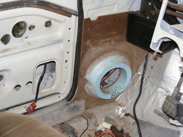

let me see if I have the pictures of the kick panels as a build
let's see if this is right.
the IDEA :sign7:

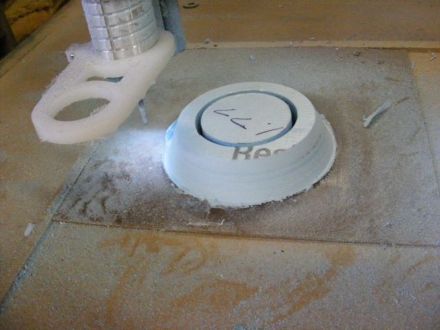

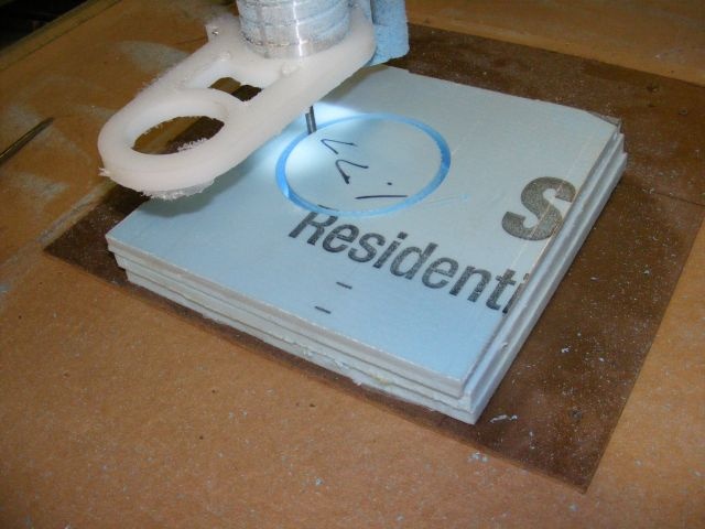

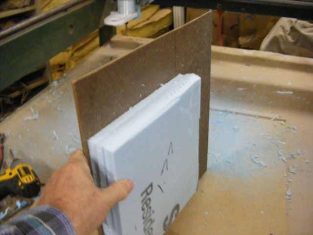

designing and making the machine do most of the grunt work.

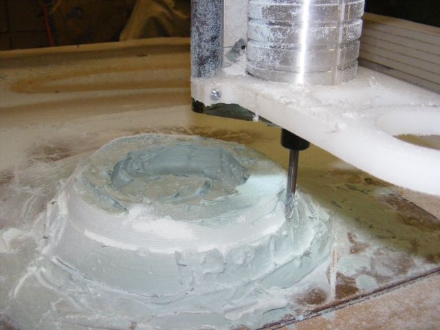

basic shape cut out for the speaker.
test fit , adjust and test again. (many times.)

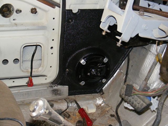

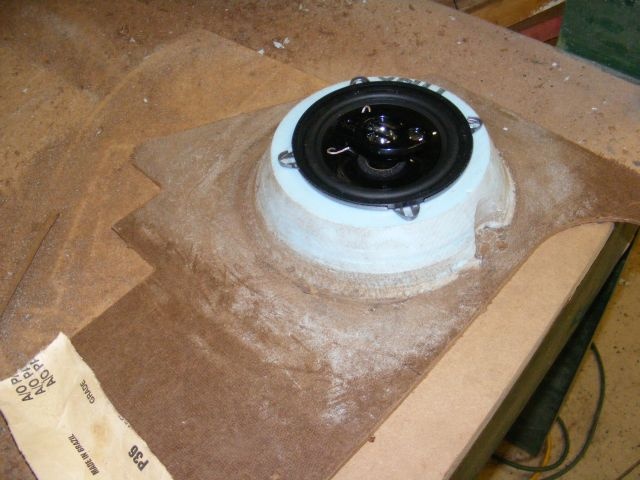

don't forget to check the speaker too!

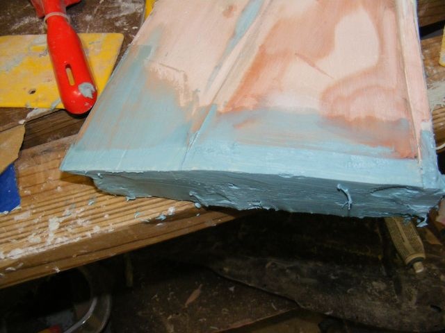

after you like it them it's BONDO time. yep lotsa bondo!

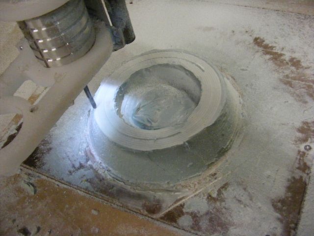

here I'm cutting the outside shape to a nice even slope.

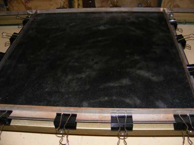

ok molds ready , check.
plastic cut to fit vacuform,check
ahhh HEAT! check
it was cold outside too (for Florida that is in the 30's.)
plastic mounted and waiting on me.

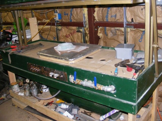

dang it's dirty. forgot to clean it off .

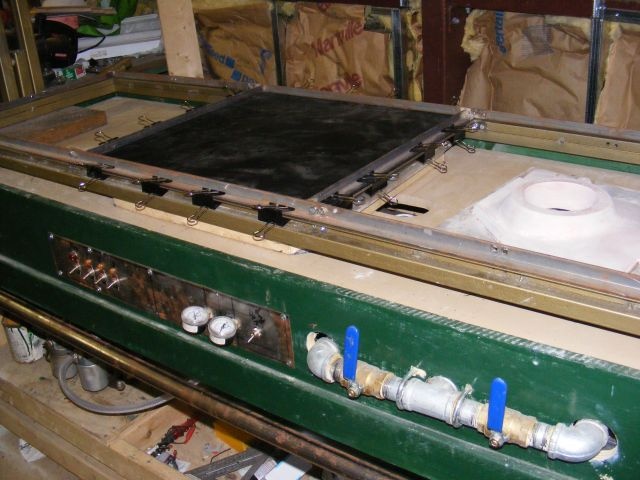

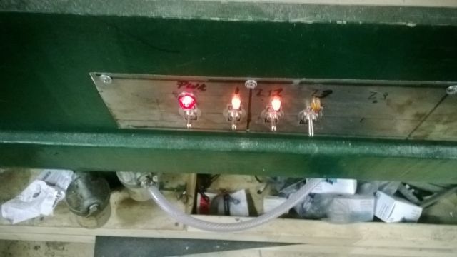

only need one zone for the 2'x2' platen

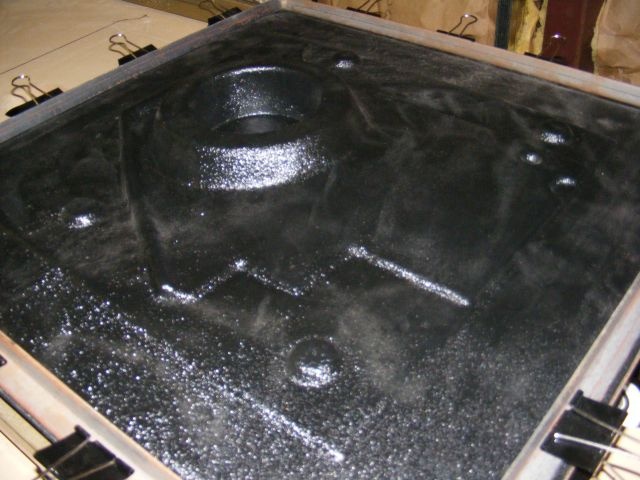

slipped the mold in and raised the plastic up to the heat to soften it.
got it hot enough and down it came on the mold.

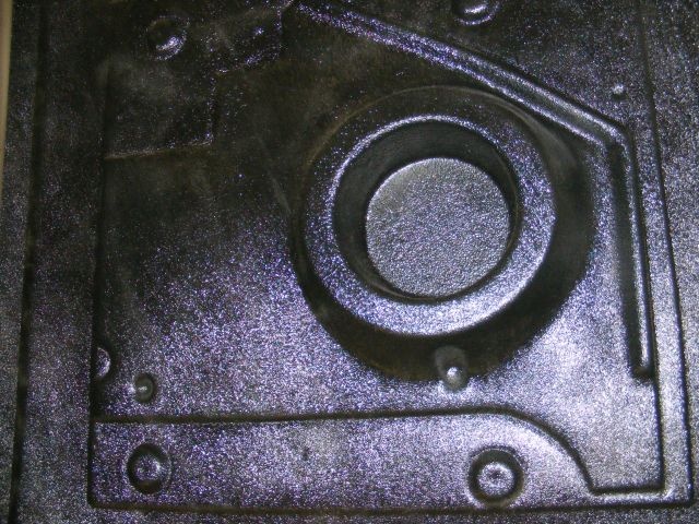

popped the part off the mold and cooled it down
passengers side is already cut out and drivers side is next
and test fit again to make sure I didn't screw up.
lotsa test fits and not too bad a setup. I probably have 70 hours total into making the 2 molds, so it's not cost effective as a production setup but it's good for a short run setup. and another couple of hours cutting them out and trimming them to look good.

The stainless trim fit may not be a problem with your molded part, but rather the trim itself. I just checked out my '64 and one side is off by about 1/8" in one area, while the other side closely follows the recess.
Might be worth looking at some other examples before blaming your mold.
thanks
I've only got the one set though. hmm looks like I'll be making a trip to Waggins house since I know he's got one in the shop and one in the yard that has those panels. plus he's got a neat hidden radio mount panel in the glove box in one of the cars I want to take some measurements of for mine!

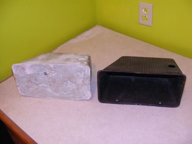

and you can see the reason it's got to be a female mold (with the male plug as a shape finisher) due to the Deep draw of the plastic. the plastic wants to stretch too much with a male mold and makes webbing at 3 of the 4 corners. I did the male mold and discovered that it wouldn't work for that reason.
lip on the edges

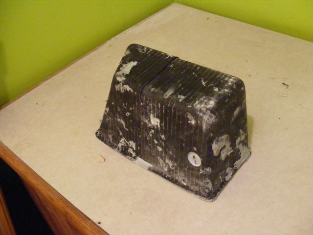

better view of the deep draw(height) versus the width and length.

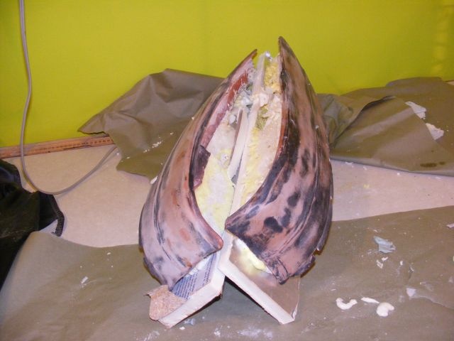

first attempt for the glovebox mold making. didn't work very well. and made me realise that it had to be a female draw down mold instead of a male. now to learn how to do one of them:D
