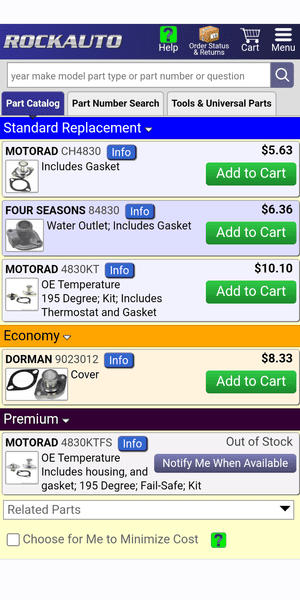

Buy parts for 67 dart with 273.

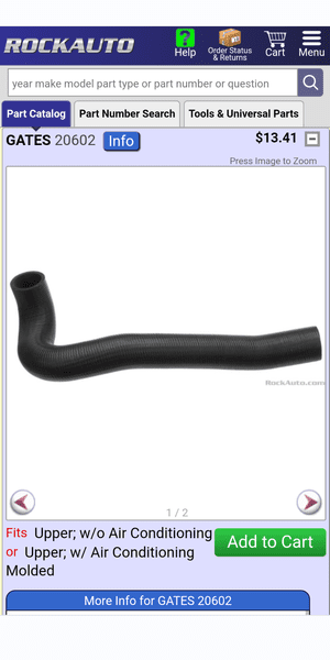

The upper hose will be the same AC vs Non AC

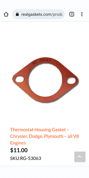

Best t-stat gasket you will ever buy.
Be sure to clean out the bolt holes and follow the installation instructions 100% not a drop in 5+ years
