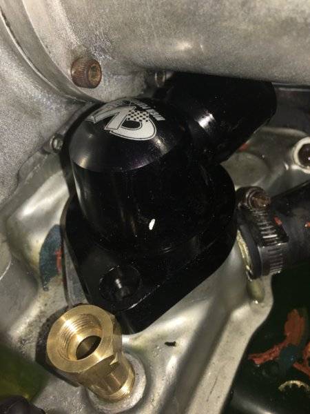

I would like to find something that I don’t have to pull the blower off every time. Might look for something with a lower profile on the mounting edge to slide between the blower. Thanks for everyone’s input.
You're lucky, on most of the DLI manifolds the thermostat housing is welded shut. Notice the two nipples welded in on the manifold..
Well after about two months of fooling around with the chrome piece(had it surfaced) and purchased multiple water necks I found the right set up. Along the way carburetor leaks and wiring issues! Ha! Back on the road.
FYI, ended up buying three different water necks and spending about $480 total on it. Now I have three brand new water neck paper weights!
