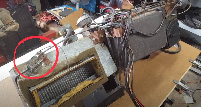

That probe on that part goes into the AC Evaporator and is mounted on the outside case of the heater/AC box under the dash
The probe goes into the evaporator? Through an opening somewhere? Or just push it in anywhere between the fins?

I’m not sure about how theirs mounts. I’m just showing how/where the factory one mounts. There is a hole in the side of the heater box where the probe slides in and through the evaporator. The factory unit also activates a cable. It’s possible theirs mounts somewhere else?

I'm somewhat facing the same questions myself.. but a totally different scenario. I'm doing a Hemi swap. But last year, I did do a complete revamp, upgrading to a sanden style compressor kit from Original Air and it came with that thermostat. I opted not to use it at the time because I knew there was already a thermostat in the box that also acts a compressor switch.. so I just left things as is. The switch allows current to the compressor (with a binary switch in there somewhere) but also has the thermostat built into it that allows for it to thermally shut off if it detects a freeze. So the switch is kinda needed or the compressor will just run no matter what the temp is set at.. you can here the switch click as you slide the temp up and down.
The aftermarket switch can be added to the firewall and the probe can be carefully wrapped around the low side (larger) fitting and tube coming out of the firewall. Clean the fitting and metal tube portion of that line with scotch bright, sand paper, wire etc brush prior to wrapping the probe around it. DO NOT kink the probe. Use a small hose clamp and lightly clamp it in place, holding it firmly to the tube. Use the black butyl tape to wrap around the fitting and probe to insulate it from engine heat. The wire that runs to the compressor will need to be cut and routed through the switch.. 1 terminal is power in and the other is power out. Basically cut the wire in two, put female terminal on each end and plug it into the switch... direction doesn't matter. I'm not sure about that filter tho.
The way I'm thinking of doing it is to put the probe in it's original placement in the evap core. I've read that it only needs to go in a few inches (giggity). It's a hard spot to get o but since my column is loose right now, it might not be too bad. But, the original switch needs to remain wired and the wire just needs to be cut after the switch and routed through the new thermostat. I'll just move the original probe up outta the way somewhere and mount the new switch someplace convenient .
