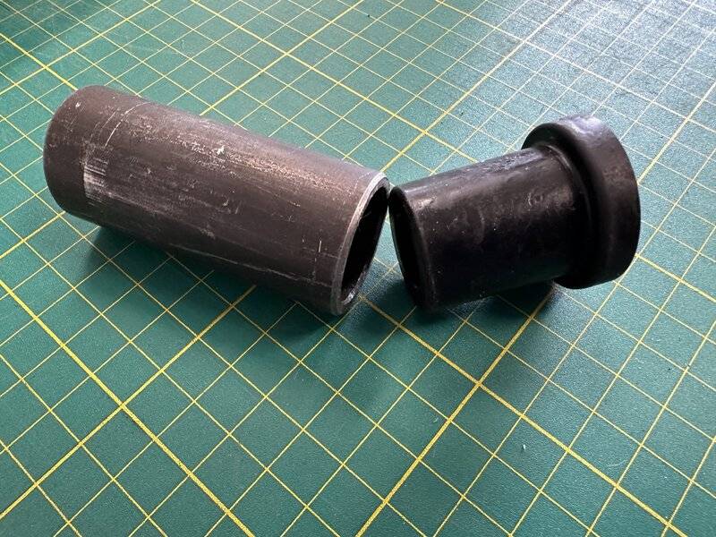

Just installed the USCT rear springs inboard kit and had one problem. There is no way the shackle bushing will fit into the sleeve that gets welded in. Is there a smaller diameter bushing or did I get the wrong sleeve?
There are small and large bushings. I know E body uses a larger dia bushing, I believe its 1". A body uses the smaller bushing but I dont know if that applies to all of them.
I got the wrong bushings twice from rock auto so I ended up getting them from Mancini.
I have a pair of sleeves I made up but did not use. They are for the larger 1" bushings. Let me know if your interested in them.
I’m going to try to find the correct bushings first. It I can’t find them, I’ll reach out to you.

@-Boosted- - Sorry for the derail. Re. your original question: like others said, I think they made 1" and 7/8" bushings, depending on body type. Lots of aftermarket kits, springs, etc., mix these up. I have to buy two kits to replace the shackle bushings in my setup. But then I have enough to do it twice. haha.

I have a lathe, can make up some bushings if needed. I have not test fit them yet. I plan on shimming as needed to remove as much slop as I can in the assembly.
