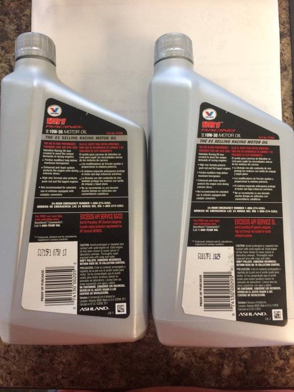

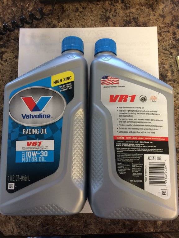

I bought 6 quarts and two of them are different. What changed and should I run it or order two more and hope they match?

That would annoy me just a bit, but I wouldn't hesitate to run them together unless the engine requires the high zinc for a flat tappet cam.
If that is the case I wouldn't use the non high zinc.

They had to order it in by the case so I had them swap out the other four. I now have 6 matching quarts of oil. I'm sure they hate me by now.
From my understanding and their spec sheets, all VR1 “Racing” oil is the high zinc. I’ve seen their “racing” oils quarts with varying stickers. Think it’s just for marketing.
They only have two kinds of “racing” (VR1) oil. Synth and non-synth

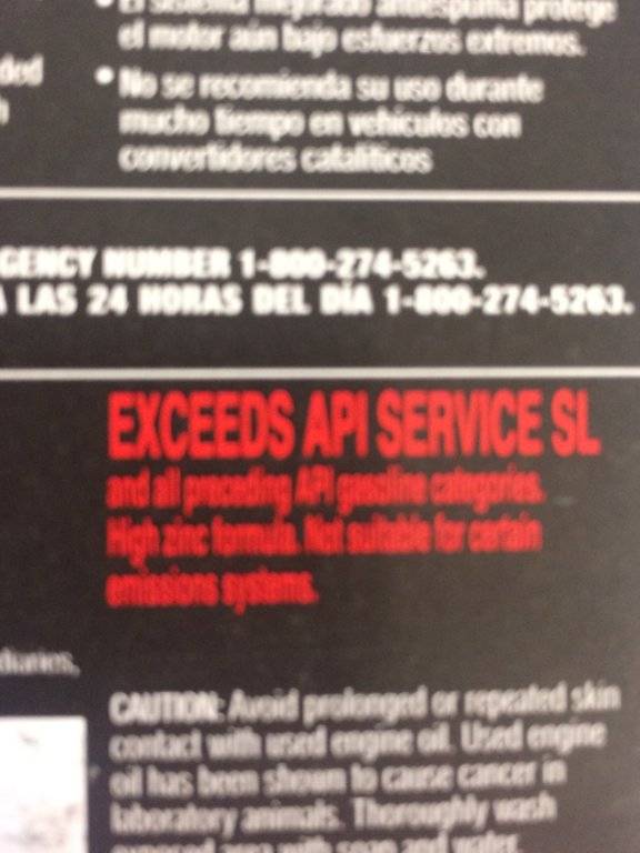

Just read an article from Engine Builders mag....SL still had 800 ppm zddp.... I stand corrected. It's SM that's devoid of zddp....
Ya. 800 -1100 seems to be the content level for the “high zinc” advertised products now.

VR-1 has always been advertised as the high ZDDP oil, so I was certain it was just the new bottle design (you know the type; same product different look) when I bought mine last. If you look at the first bottle in the third picture it also says it exceeds SL in the smaller print. I haven't seen the new blue labels, though, but probably will when I go buy them in a couple of months. The O'Reilly's near me usually stocks 10W30. For some reason they only put 20W50 on the shelves and keep 10W30 in the back.
