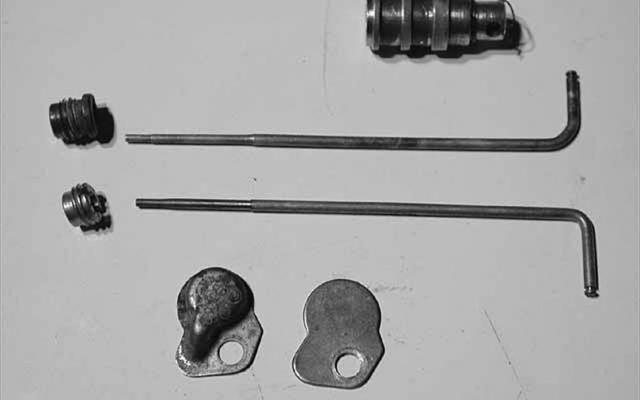

3 step rods were used with the AVS with tall jets and domed rod covers and the AFB used a 2 step rod short jet and a flat cover. Just be sure use the right groups. If you can afford it buy the Edelbrock Strip Kit and use the flat top covers.
Right on the AVS, but the older AFB's used the 3-step rods, tall jets, and domed covers as well. My '67 4295S AFB has the tall stuff, and incorrect size rods, so I'm just trying to get back to stock calibration.
Yes high jets and 3-step rods are listed in factory part and repair manuals for AFB back as far as 66 (haven't looked back earlier).
I have a few old factory AFB's from the early 60's and they also use the 3 stepjets/long rods/domed covers. I have a #4200 AFB ('62-'64 383/413) and it has tall stuff!
Still looking....A pic of old (tall) versus new (short) style jets, rods and domed (old) and flat (new) style covers.......
