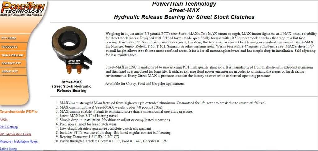

Hi all, as the title says, im wondering if anyone here that has used or is using a Powertrain Technology hydraulic release bearing, in particular their Street-Max one, i have been quoted by them a price of $319 US which im ok with, but what i'm unsure of is the website says it does't need any shims / or anything to adjust so how do you set up the gap between it and clutch fingers? i'm a bit of a newbie when it comes to these things so any advice is much appreciated.
Looks like that one "turns" to set the gap. Google how to set it up and I'll bet you find a bunch of videos.

hey guys, i ended up getting just the streetmax hydraulic throwout bearing, and after installing it, and bleeding it for ages, it still wont disengage the clutch! So now i need to find out whats going on and would love some advice, could there still be air in the system? Could the master cylinder not have enough stroke? It's a 3/4 bore 1.4" stroke. Theres about 5mm gap between diaphragm fingers and bearing face, pedal feels ok but just feels like it needs more travel.
Any advice appreciated thanks.
UPDATE: I have bled bled bled the system and it has improved to the point that i can force reverse in, and force 3rd and 4th gear while motor running but not 1st / 2nd. It just needs to push the pressure plate fingers just a little bit more, should i try a longer stroke master cyl?
