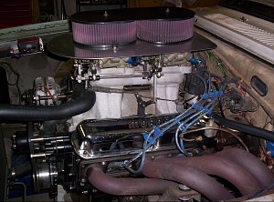

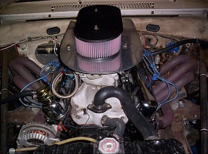

1965 Valiant 2dr sedan, I purchased this car as a runner, 170 slant 6 w/ 3 speed on the column. I drove it as a daily driver for about 2 years then stored it from 1995 until making a race car 2004. It has a 1973 340 block .060, STD steel crank out of a poly 318, Eagle SIR rods, Comp roller cam, Edelbrock tunnel ram, 2 Holley 660 center squirters mounted sideways, TRW 12.5-1 pistons (with the over bore, the block decking and head milling it is about 14-1), X heads with 2.05 / 1.625 valves...
