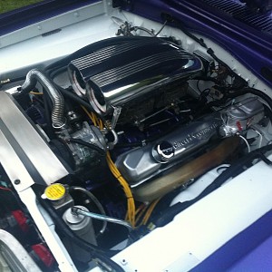

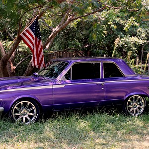

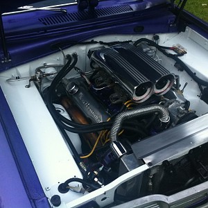

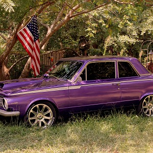

Finally completed the Purple Beast. It has been a long traveled road.
She started out as a boneyard find, destine to be crushed, some 20yrs ago. /6 auto on the column, with rough interior but solid metal. She is now powered by a 1960 361 Golden Commando, dual 4bbl, 0.030, and iron 440hp Manifolds. Purple cam, .292/.509 hydraulic, twin 600cfm Eldebrocks, iron 346 (casting) heads. Pocket Ported and polished, all gasket matched. Power transferred thru a 727, Cheetah reverse manual valve body, 8" converter, 4" aluminum driveshaft to a 742(casting) 8.75 housing...
