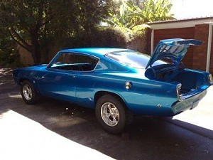

Car was imported to Australia in 1990 from California and "converted" to RHD in poorly done job. Since purchase in 2001 I've re-done the RHD conversion properly, fast ratio rack and pinion steering mounted off K member (rearwards that is, to match the location of the stock draglink), tubular upper control arms boxed lowers, converted from A 904 to A833 console shifter, hydraulic clutch, now building 408 roller cam stroker, owner made aluminium dash with classic instruments guages, 8 3/4...
