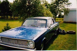

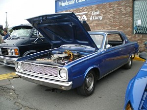

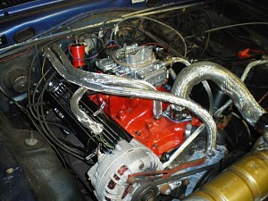

:angry7:Here are some pictures of my 66 Valiant Signet (aka Dart GT) with a modified 1968 318. It has a new 650 Holley with vacuum secondarys MSD ignition system with 8mm Acell wires
The mods to the engine are:
heads and block are plained
bored out 10 over
true flat top pistons
zero clearance between top of block and top of piston
.429/.444 lift Mopar purple camshaft
2 1/2" single exhaust with Flowmaster 40 series muffler.
