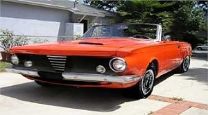

Step by step. She finally sits right and rolls right with an alignment, nice wheels and tires. Next step is the exhaust system and a little trans work

Finally a running engine. Also replaced the dinky rear end with an 8 1/4 mopar so now it's sits nice on 14" wheels all around.

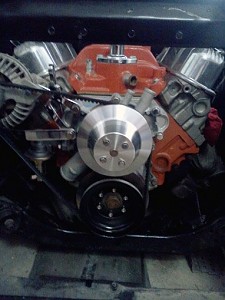

For the engine I got some swirl port heads with hardened valve seats, completely rebuilt with 3 angle grind etc. , added an Isky cam, an edelbrock highrise manifold and a 4 barrel. Along the way Upgraded the water pump and timing chain housing, and some shiny chrome stuff.

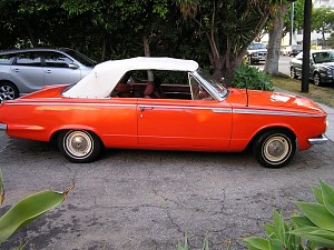

She was loose as a goose in every way, bushings bearings, all worn out. But she could still make those little 13 inch wheels squeal at will. I grew to love her.

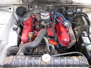

Bought this car with just a quick drive around the block. On the drive home on the freeway i realized the rear wheel bearings where gone, she squealed like a pig on the freeway, LOL!!
