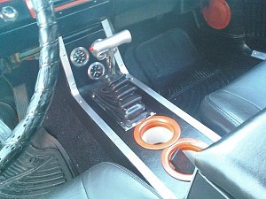

i got the seats out of a 200 subaru legacy and the driver side is power and i built the console from scratch out of 1/2 inch finish plywood and body filler than wrapped it in black vinyl and made my own cup holders out sink drain rings the only thing i could find the right size
