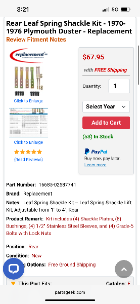

I’m not sure what direction I want to go with the stance of my ‘72 Duster. I don’t want to buy custom leaf springs and longer shocks until im sure what height I want the rear to be.
That being said i was thinking about purchasing some adjustable lift shackles to try out. Has anyone used these or anything similar?
Sure, lots of people used them. That and a set of air shocks and you're ready to destroy your springs, shock mounts, suspension geometry and any semblance of decent handling your car might have had. As far as lift goes they're only good for about half as much lift as you add in shackle length because of the spring geometry.

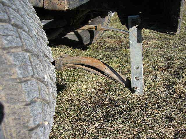

Good for the springs too!
