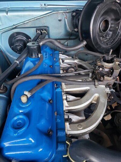

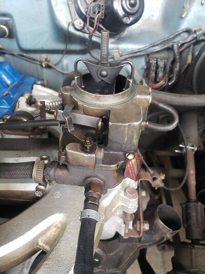

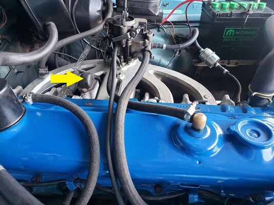

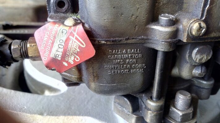

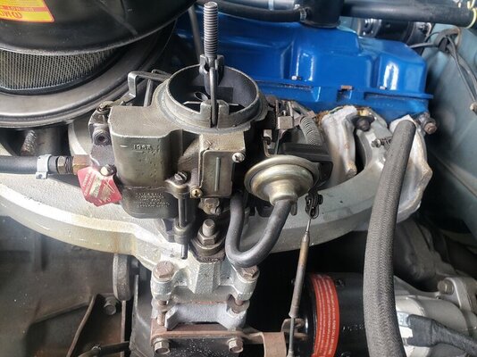

Hi MichiDart
I also have a '71 198ci and it's equipped with an Autoline C6018 carburetor, which is in fact a rebuilt Carter Ball & Ball. Not recent, but works like a charm.
Here are some pictures of the carb in situation
If you need a more precise picture of the linkage, just ask
François

Thanks French. Carb went on pretty easy. Might be interested in pics showing vac line setup. Unfortunately carb switch did not solve my issue. Next guess is fuel line from tank to under hood. Getting to the point I may take it to "professionals". It needed all the new stuff I put on but I need to find the cause of it running poorly.
