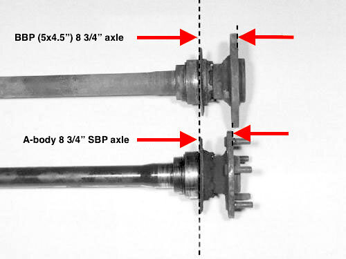

There are no 10 x 2.5 SBP backing plates. Original A-Body SBP rear 10 in brakes are 10.75. Original 73 up BBP 10 in A-Body rear brakes are 2.5. The backing plates are different than the SBP backing plates. But the 10 x 2.5 brakes came on most other platforms including PU Trucks.
The backing plate offset from SBP to BBP brakes is different, because the axle flange offset is different between SBP and BBP axles.
So if you’re switching from SBP brakes to BBP brakes, you also need to be switching from SBP axles to BBP axles (and not just a re-drill either)

When you talk about SBP vs BBP if you switch from one to the other the lug hole locations change along with the hub bore. So yes you are talking about drums and axles unless you plan on re-drilling the ones you have.
