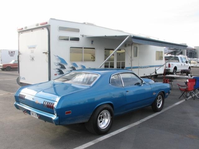

I ran a 10" wide rim on my Demon it was a 12.50 X 28" MT quick time tire. No mini tub work but it did have the leaf springs moved in .75 on each side and the front edge on the fenders trimmed for the height of the tire. This worked ok but they did rub when hitting bumps, The tires wouldn't really tuck in the fenders. For a street car I would stay with a tire a little narrower.

The Demon was running a 5" BS stock width 8-3/4 rear end. It did have disk brakes that pushed the wheels out a little maybe 1/4 to 1/2" on each side
They had enough clearance off the inside leaf springs and they still would of fit if I didn't have that set up.
In my opinion 26" tall tire doesn't look right on the back of these cars. I would try and stay at least 27" but that's just a personal opinion. :D

It's always a good idea to measure. Forty year old cars, someone could of swapped the "A" body rear end for a "B" body rear end out of another car. The 5" worked for me but I did move the springs in 3/4" on each side for leaf spring clearance.

Front tires were M.T. 28" tall. Think they were 4.5 or 5.5" wide The Demon had fiberglass front fenders and there was no issue with rubbing on the fronts.
