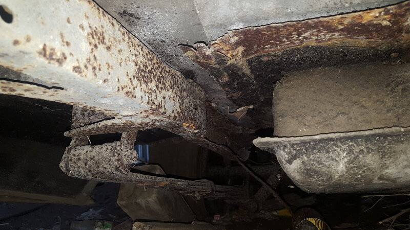

Tell me this trunk floor isn't worth the effort to buy/ship, and I should just make one out of flat steel on top of square steel tubing.
My trunk in first pic, gas tank was attached to bottom of trunk floor, but there really isn't anything worth keeping.
Trunk dropoffs/extensions and floor patches are garbage galvanized sheets spot welded, yes, spot welded, to the rusty floor.

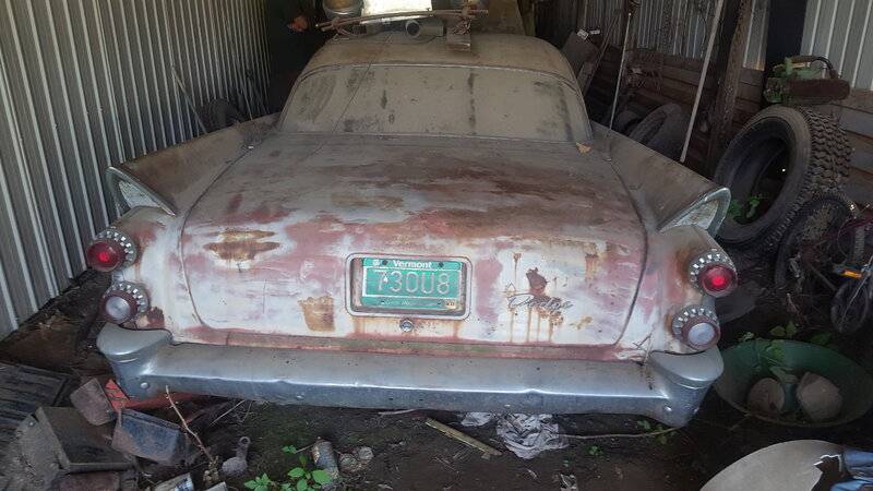

I loved the castellated tail light housings on the 58. So much so, that I found a set & replaced the ordinary looking front parkers on my 61 Dodge with them.
Cool!
I often thought the 58 tail lights could be a direct swap into a 62 Plymouth, they look very similar.
