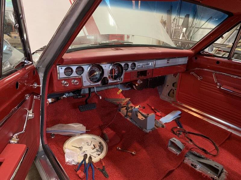

Here is mine all tricked out.
I went with the factory radio but it was not installed yet (at that point)
