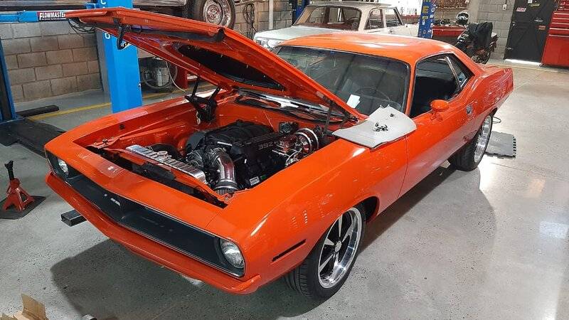

What transmission do have. Do you have any vacuum leaks. Beautiful Cuda by the way. Post a pic of the 6.4 in there. We like to see all the realestate those Ebodies have.
Thanks, it was a really nice restoration project! The car has a T56 6 speed manual transmission. We double-checked all vacuum lines and ports and threre are no leaks.

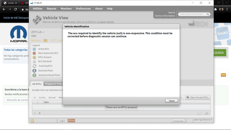

Finally I bought the Witech 2.0 scanner and tried to connect to the ECU, but the software show me the following error message and I can't access to any menu to do the Pedal learn procedure. Could you give me some advice? As you can see in the pictures bellow, the scanner complete de connectivity procedure but can't access to the ECU. Could be a damage ECU?

I just remembered I had a similar problem with mine. 1 of many. It was a ground problem. The trans ground was loose and my battery was in the trunk and I had to add a ground from the battery the chassis(bumper bracket bolts). You may need more grounds.
I checked the ground a couple of times, due to the original error, but I'll do again and I let you know if something change. Thanks!
