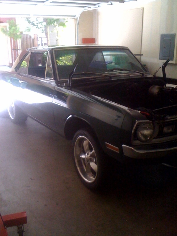

Hi guys,
I am looking to buy a center console for my 1971 dodge dart coupe. originally it had a bench, but I have installed buckets. Now I am looking for an original mopar center console that fits well and doesn't require a lot of fabrication to make it fit. car's an automatic transmission 904 slant six drive train. got any suggestions? thanks.
