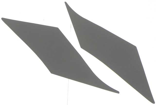

Unfortunately, I don't have any. All I have are these (see pic).....They fit in the same area, and are covered with headliner material. Do you think they will suffice as a backer for the new headliner?
I see that Classic lists a whole bunch of different types for the '71 Demon.
You could make a template with cardboard use that to make a couple panels out of your material of choice. I did that for similar panels for my '66 Dart. I used thin aluminum sheet and riveted it in before laying down some insulation followed by the headliner.
I have a bunch of originals for patterns. I could tape some paper together and trace it on and mail it. I bought those same panels you did. They are not close. I think they are for a 72-76 swinger. do you have the clips?
