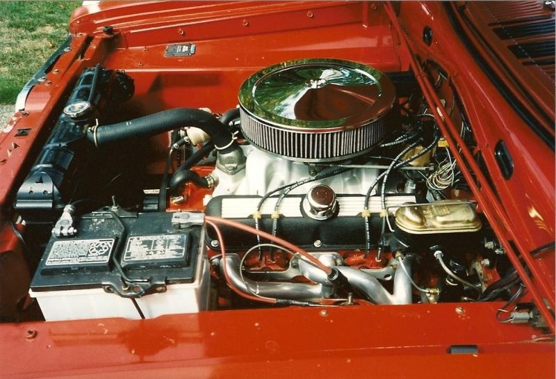

I agree, transfer all the stuff from your 273 to the 360. The 360 should have the timing marks cast into the front cover and will be a little difficult to see but is do-able. I put all the 273 stuff on my 66 Barracuda and it worked out just fine.
Commando66, can you post a pic showing how easy/hard it is to see the timing marks? I need to make a decision about a balancer myself. There's a lot better selection of performance balancers in the later style.
...and PLEASE Commando66, tell us what brand of headers you are using!!! That's one sweet and clean job you've done there!!! Geof
Sorry, the car is all torn apart so no current shots. Cosgig, I had those made about 18 years ago. When I tore the car down, I sold a few parts including the headers. I've got a set of 1 3/4" to 1 7/8" step headers made for the car now.
