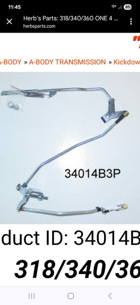

Hi everyone.
I have a 1973 Duster with a 318 with an 904 and I recently put the motor back in (after 8 months), I’m trying to set up the throttle linkage. Unfortunately, when I took it apart I was trying to convert to a manual and failed to take pictures of the throttle linkage with the auto. At this point the manual swap has been put on the back burner and the auto is going back in.
Does anyone have pictures of the throttle linkage set up for reference or any suggestions and reference pictures on how to convert it to a cable?
And here is the underside kickdown linkage on a 727 in a '76 Truck.
You didn't mention this, but keep in mind that the linkages are different between a 2bbl. and a 4bbl., so if you converted to a 4 bbl. while the engine was out, none of the 2bbl. linkages are going to fit "as is".
