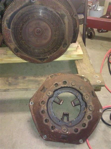

Well folks, I’ve got the 383 and four speed out of the car.
This is what I’m planning to try. Won’t hurt to try.
I’ve “only” got 600 bucks in the cast crank 440 from the junkyard man, and I’m hopeful that this will work and keep it a bucks down swap.
What you are looking at now are pictures of the 383 with its flywheel and a rough mock up of a fixture to drill the 440-cast crank for the four speed input shaft.
The 440 has a hole started (see earlier pics) but just not deep enough.

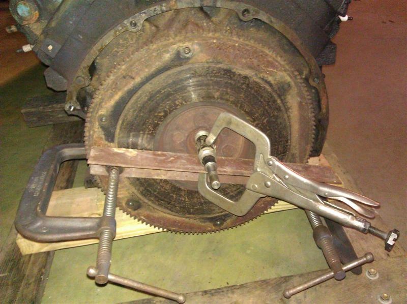

I’ll swap the flywheel over to the 440 and use it for a perpendicular surface to try it and get things lined up.
Weld the pipe nipple on the angle iron. Maybe back it up and use the flywheel as a true surface.
In other words, it won’t be as far in as in the pictures.
Or maybe come up with something else for a “pilot”.
The four speed input shaft is ¾ and that’s the largest drill I’ve got on hand with a ½ step down shaft for a hand drill
But if I can get slightly larger bit, that would be better to accommodate errors and allow for a ¾ shaft size.
Ideally one of those magnetic base portable drill presses would work too.
But I don’t have one. And who knows what a rental store would have or cost.

I used the 383 with flywheel to make a fixture to drill the 440-cast crank for what remains of the input shaft.
I found a bit of scrap tube with an ID of 7/8 (.875) I used copper pipe with an OD of .875 as a guide to line it up with the existing .875 hole in the 383, clamped the tube (see previous pictures of rough idea) and tacked it on angle iron.
Pardon the welding. I didn’t want to risk burning into the thin tube.
Then I transferred the “jig” to the 440 and started drilling. The long copper pipe was used as a depth gage. Note the scribe marks on the brown copper pipe for depth measurment.
I take one at the top of the hole and one at the bottom shoulder.
