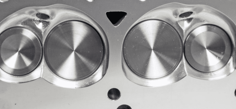

Trick flow 240 chambers.
Spark plug holes are clearly angled.
