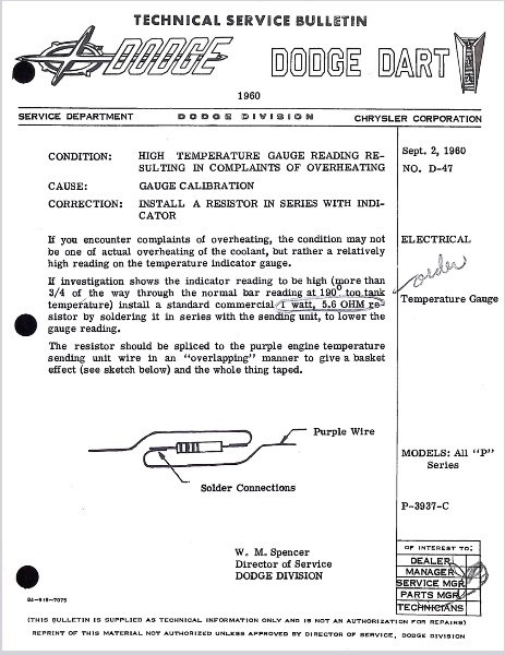

Might have to do with the change in temperature senders from '63 to '64. The early ('60-'63) senders have 13.5 - 15.5 Ω resistance at 220°F. The '64-up senders have 15 - 19 Ω resistance at 220°F.
Imagine two senders, one early and one late, in the middle of their respective resistance ranges. So, 14.5Ω for the early-type sender and 17Ω for the late-type sender. That's about a 16% difference, enough to visibly affect where the needle sits on the gauge face.
Assuming a gauge that reads correctly, using an early sender instead of a late sender will result in a higher reading, or using a late sender instead of an early sender will result in a lower reading.
The weird thing, tho, is that the same part number (2291 021) is specified for the '63 and '64 Dart gauges. So either that's a catalogue error, or it's not an error and they just didn't care that the needle would look like it was showing a lower reading on a '64 Dart than on a '63, both at the same actual engine temperature.
The early sender uses larger (1/4" dryseal pipe) threads, and a coin-shaped terminal; the wire slides on at right angles to the axis of the sender. The late sender uses smaller (1/8" dryseal pipe) threads, and has a stud-type terminal; the wire pushes on in line with the axis of the sender (or yeah, you can use a ring terminal and a nut to secure it, because the thread is studded…er…wtvr, you know what I meant). Easy enough to put a late sender in an early head by using a 1/4" to 1/8" pipe thread reducer bushing, but going the other way is harder. Not impossible, but more effort.
All of which to say: sometime in this car's past, someone might have installed some '63-down components, or maybe someone just installed a wrong sender, with less-than-stock resistance so the gauge wants to read high. Or maybe the gauge itself just drifted hotward over the years.
There's precedent for the use of a resistor as you describe; take a look:
I want to run a new wire to the bulkhead.
Good idea.
Thanks everyone for the great insights. Funny about the factory service hack to mollify the customer. Anyway, my plan is:
1) replace the sketchy ancient wire without the resistor to get the gauge working.
2) start and run the car, radiator cap off, until the thermostat opens
3) check the temp of coolant and see what 'normal' operating temp looks like on the gauge
4) Decide at that point to swap sensor out, add back in the resistor or do nothing. I am the only one that drives and maintains the car, so even if the gauge shows hot or cool from reality, I'll know where safe is.
