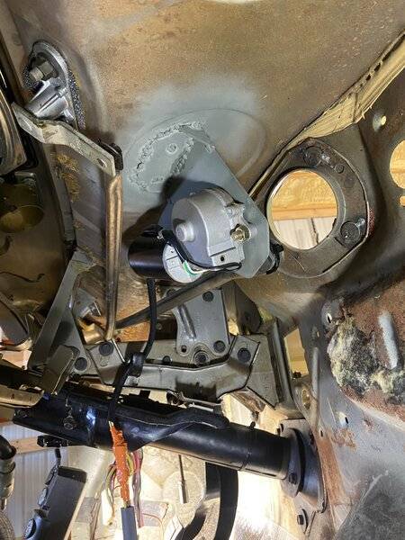

It works totally fine. Same setup I used when it was a 340. The only difference is I had to move the lower bearing back 1” to clear the valve covers.
I used a 90s era Dakota wiper motor. Mine is mounted inside under the dash, but there's no reason you couldn't make an adapter plate and mount it on the outside. It was a very easy conversion. I even used the factory wiper switch. it took some figuring out, but I got it done. The bonus is the wipers actually move fast enough to help, unlike the stock 2 speed motor.
I looked at a picture of one, it looks like it will be a very good fit. It appears to be a lot smaller. I will just flip it upside down and mount on the firewall like original.
Thank you!

In case anyone is paying attention or wondering in years to come. I switched out the fabricated mid sump Weiand oil pan to a Mopar rear sump pan. I gained some room forward and down. Angle is now 2.5 degrees down. I cut out the windshield wiper area, the firewall bellhousing area and a small area where the drivers header was hitting the fire wall. Since changing the pan I get to weld all those things back in. Fits way better now.

I've been working on my research for my swap and ran across a copy of the 6.2 Hellcat swap instructions from Mopar and they suggested a 2 degree downward slope on the trans. For what it's worth. Doubt it matters, just tossing it out there.
I'm paying attention. :D
Yes, in the crate wiring kit instructions it says the Hemis are put in the new cars at 2 degrees down. Most engines are 2-4 degrees down. With the other oil pan it was about 3.5 degrees down. I need to put it on wheels and see what the clearance is from ground to oil pan. My car will have a bit of a rake so that should take care of the extra half degree. If not I will park it on a downward slope.‍♂️
