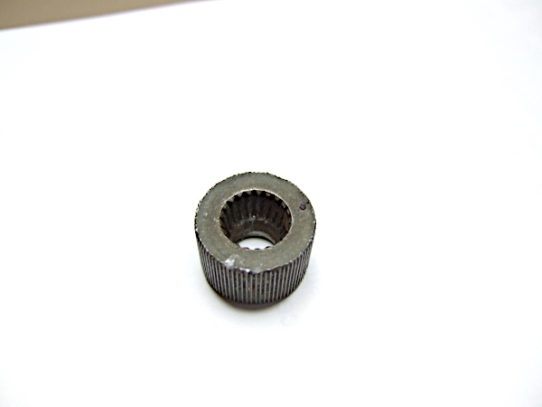

I cannot find a part number or listing in the MoPar Passenger Car Parts Catalog "R2 Series 1961 for the windshield wiper arm drive bushings.
I'm thinking my sense of terminology is out of kilter with MoPar-ese. Therefore no ability to find them through our now merely half *** smart search engines!
images attached.
Thank you, as always.
Those were never Chrysler parts. They came with aftermarket universal replacement wiper arms such as the Anco 41-03, to convert the pre-'65 wiper arm attachment point (cone spline with a central bolt) to the '65-up attachment point (drum spline with angled spring retention).
The 41-03 was a great product, but it was discontinued some years ago. Plenty of Google hits, but all of them are dead ends. :-(

I snarfed up 2prs. Anco 42-03 adapters that seem to be the ones used for the 41-03 arms for our cars of discussion.
!! fingers crossed, of course.
Also had to buy a pair of these as the splines here too are smeared.
1960-1962 Plymouth Dodge A-Body Windshield Wiper Pivot Assembly 2448633 NOS​
Blimy all to HADES they put kick in the arse for cost!!! BUT, I did finally find a pair.
