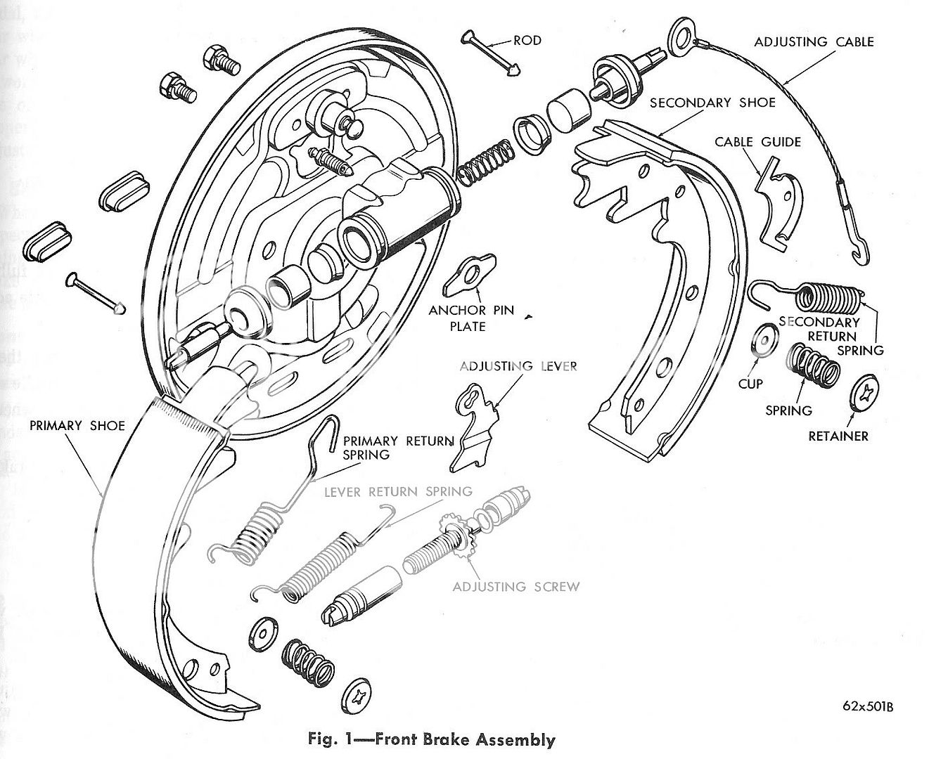

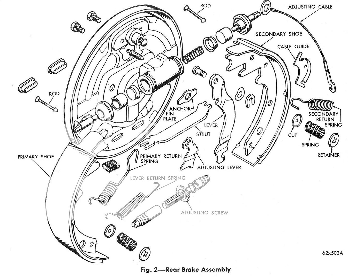

does anyone have an exploded view of the front drum assembly?
more importantly I need to know how the self adjuster mech. and springs are setup. My problem upon disassembly my right brake hardware was different than left and there are parts missing.
Here are some scans of the exploded diagrams. :)
Front Brake Rear Brake
