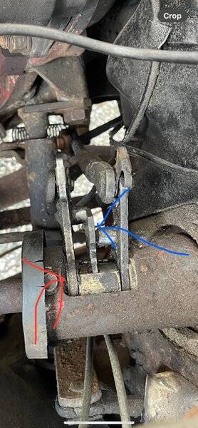

I’m reaching out because I’m curious if anyone has had a similar issue with excessive play in the shift linkage from being almost 60 years old? Is there an available shim kit or do I need to fab something up? Would love to hear from you! See attached photo but the issue is sometimes when I’m going from 3rd to neutral and back into first at a stop light it misses first and gets stuck under the arm because there’s so much play.
I can make a video if needed but I think I can solve this by simply shimming the linkage.
Red arrow in picture there is to much play causing the little piece that grabs the arms to put into gear, miss.
Blue arrow you can see the little piece that grabs the arms is barely grabbing 1st
