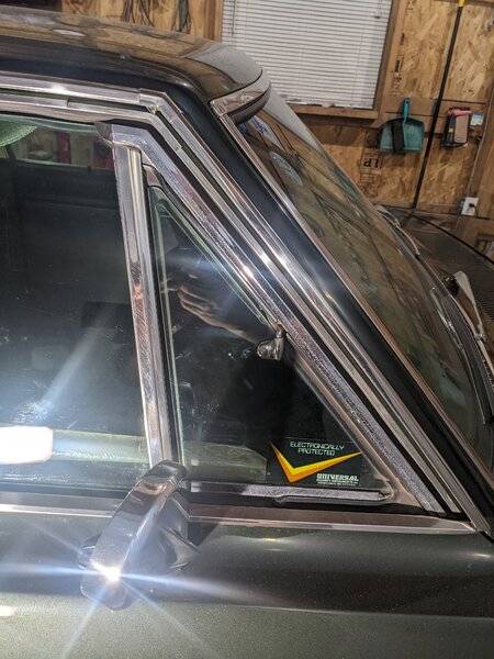

Looks like vent frame is aligned to A pillor and uniformly hitting A pillor weather strip.
In this pic, the leading edge of the glass looks off.
look at the stainless trim. It is off by about 1/8 inch in the pic.
I'm betting the vent window frame is off.
