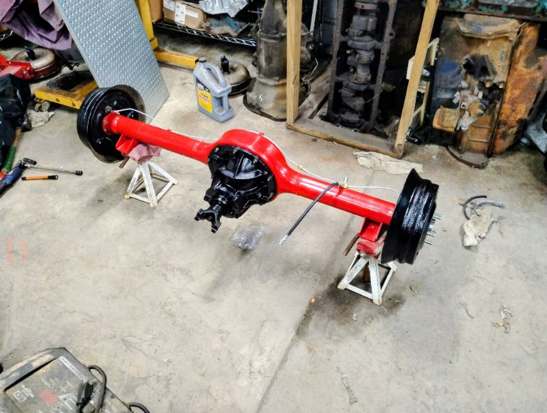

No. They are different open to sure grip. Even the two pinion cone style sure grips have different spider gears. The one thing that all three share is that they are damn near impossible to find. I would upgrade to either an 8.25 or an 8.8 Ford. I just got done with a Ford 9" for my 64 Valiant. I still have less than 850 bucks in it. You cain't touch an 8.75 for that.
