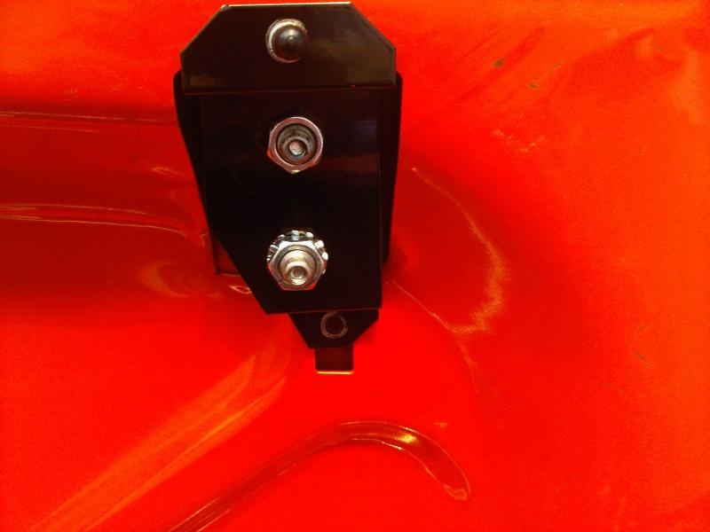

My "71 Demon" has what may be a go wing trunk lid based on there being what look like factory cutouts and holes in the understructure. No holes drilled through the skin. I would like to put a go wing on the track car. Can anybody post a pic of the underside attachments on one of these with a go wing please. Factory stuff only. TIA.

Thanks guys but what I really need is a pic of the underside of the trunk lid that is factory made for a go wing. Preferably a pic that also has the factory stuff installed.
My trunk lid has some cutouts and they are 36" apart like the go wing mounts. I would like to confirm that it is a go wing lid and see from below how a mounted wing gets attached.
Per the first place ad: "If your decklid panel is not factory stamped with the recesses to accept the reinforcement brackets, such recesses must be cut into the underside panel of the decklid before this kit will mount correctly."
I would just like to get confirmation that I have a go wing lid without the go wing holes drilled yet.

attachment.php
http://www.forabodiesonly.com/mopar/showthread.php?p=1061341

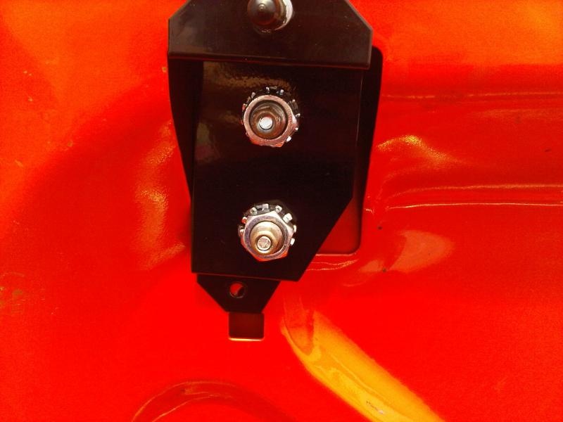

attachment.php
Thanks. That cutout does look like mine does. Woo hoo - go wing lid!
Not like this 71 lid... guess this blind squirrel got lucky finding a nut for once.
attachment.php
FYI...I have a 71 Duster that had the deck lid with the cutouts (no factory holes in lid)...got the kit for the go wing...mounted up and installed perfectly!
