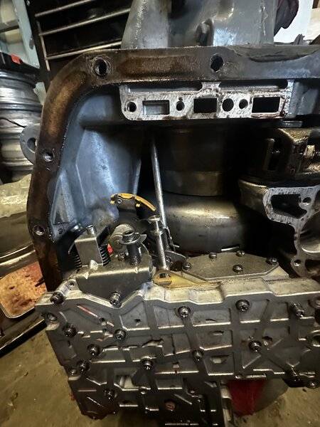

I opened up my 727 trans to install a shift kit in it and found no accumulator spring or accumulator. This is how it looked when I pulled the valve body away. Also, I cannot seem to get the rod in the last photo out. Is there some sort of trick to it?
The rod in the last photo is the park engagement rod. Turn the tail shaft a little and it will fall right out. As far as no accumulator, was this supposed to be a working trans? I can't hardly think it was.

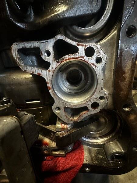

This plate does not match up with the photo on the instructions, though. Right off the bat I noticed the bottom section and where “R” is. But if you look at all of the holes the instructions says to drill it doesn’t seem like my plate has any of them.
Is there any engraving or numbers stamped on that separator plate? Or the top plate of the valve body? The factory separator plates were natural steel. That gold anodizeing is typically aftermarket.

Separator plate has 1000042-06. I have to open the valve body back up to see if it has a number
Sorry. 408 swinger is correct. That is an aftermarket separator plate. It may not be the same brand of kit that you bought but it is aftermarket.

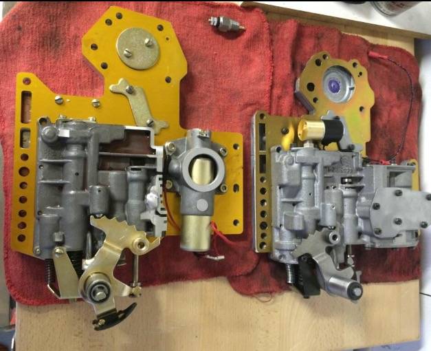

I have a Griner trans brake valve body,that does not have an accumulator piston in the trans, and a A&A and a CRT trans brake valve bodies that have the accumulator piston blocked. So I would try to identify the valve body

this is what a manual valve body looks like. I can believe that your trans was a working one as is. Even in my full manual reverse valve body TCI trans is has the accumulator piston in place, just no spring or small seal.

From the department of oversight committee…. Griner brake on the L required no accumulator. Pro Trans one on the right requires accumulator. I can attest you will burn stuff up in short order making that error. Accumulator and blocker will always be the “safe” way on a race oriented trans.

Yes, I ordered a metal accumulator. I was looking in there to see if they plugged it, but I am unsure because I have no frame of reference as to what it is supposed to look like in there and it is difficult to find photos of the hole without the accumulator in it. I am posting a better photo of it., maybe you will be able to tell me if it is blocked. I don’t think it is, there is a piece of metal back there but if you look in the top right of the hole you can see the metal does not completely cover it. If they did plug it, they did not do a good job.
